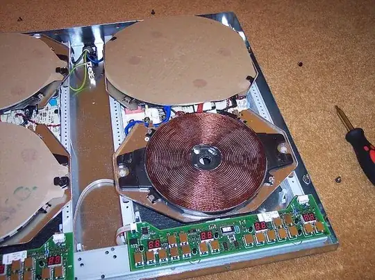

Your first assumption is not really correct. The induction cooker creates an electromagnetic field with a frequency in the range of 10 kHz to 100 kHz. The coil used in the cooker looks as follows:
open induction cooker
The coil and the frequency are choosen in such a way that the field does not extend more than a few centimeters along the axis of the setup. Now when you put a ferromagnetic material on top it will rapidly get magnetized and demagnetized with with field created by the coil. Every ferromagnetic material exhibits hysteresis, which leads to dissipation. This dissipation heats the pot. This is not connected to the resistivity of the material, as eddy currents are not the main cause of the heating (a copper pot works poorly on an induction cooker).
With the field strength rapidly decreasing with distance, it is clear why the top of the pot and the lid do not become hot. There is no even current flow through the cookware.
