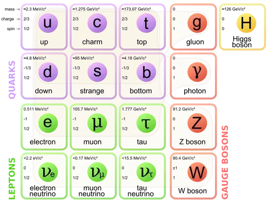

Particle physics has a set of elementary particles , some of which have zero mass.
elempart
In this table the general public has heard of the electron and maybe the photon. The mass of the electron has been measured consistent with classical definition of mass.
The mathematical theory of elementary particles is called the standard model and the table has the masses that enter in the lagrangian. These are the only masses that are generated by the Higgs mechanism.
