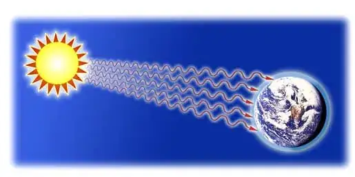

Every body which has a temperature above 0 Kelvin gives out (ie. radiates) some heat in the form of waves. (So, even we radiate!) Of course, the amount of this radiation depends on the temperature, so the more the temperature of the body, the more heat it gives out. Now, since this heat energy travels in the form of waves, it does not necessarily require any medium to travel. So, it can travel in any/no medium.
Sun heating Earth

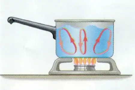

Consider a beaker of water being heated from the bottom. The water in the lower region gets heated up, becomes lighter in weight, and hence comes to the top. Now the (relatively) cooler region of water on the top comes down and begins to heat up. Now, again it gets heated up, and moves up when it becomes lighter than the (previously heated) water on the top, but this time getting more heated that the water on the top. This process continues, and eventually every molecule of water gets heated up.
As you can see, in this process, the motion of the particles lead to the heating of the whole body (water, in this case) - the warmer ones moved away from the source of heat to let the cooler ones collect the heat.
Convection in pot of water
So, its clear that convection requires a medium (specifically, a non-solid medium). Unlike radiation, if there is no medium near the source, it cannot loose its heat simply using convection. (It can of course loose it via radiation.)
