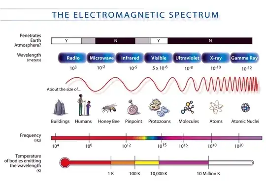

My basic knowledge of a lightbulb is that the power dissipated by the tungsten filament heats it to around 2,700–3,300K (inefficient!), emitting a yellow light. Something supporting my current (and next) claims is this image, see the bottom chart on temperatures:
With this, can I assert that fire is red (and yellow) due to the fact it is simply at those temperatures where those colours are emitted, and it happens to emit those frequency photons? What is this called? I recall "thermionic emission" however, I am unsure if this relates closely to visible light as it does "heat".

EDIT1: As a side note, the image you have attached from wikimedia is largely misleading. The color as perceived by human is strictly restricted between 400nm to 700nm. Everything beyond this range is invisible to human eyes. The large red and blue color zone in the diagram is "made-up".
