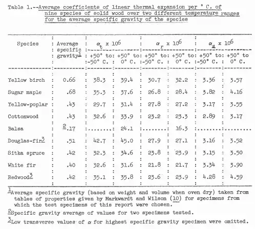

The coefficient of linear expansion of wood depends very strongly on the direction, being about 10x greater across the fiber than along it. I suspect that a clarinet is built with the wood along the length, in which case the coefficient of thermal expansion is about $3\cdot 10^{-6}~\rm{/K}$ source. The following table, from the same source, shows some of the variation between different types of wood:
We conclude that a 2°C change in temperature will change the length by 6 parts in a million - so a concert A (440 Hz) will change by 0.002 Hz. It is safe to say you would not be able to hear or measure such a small change. Note that cheap ABS instruments have a coefficient of thermal expansion that is easily 10x greater; over a wide range of temperatures they might have a small but noticeable shift in pitch.

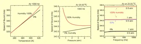

Here are some graphs showing various relationships between temperature, pressure, humidity, and speed of sound - taken from http://www.phy.mtu.edu/~suits/SpeedofSound.html :
