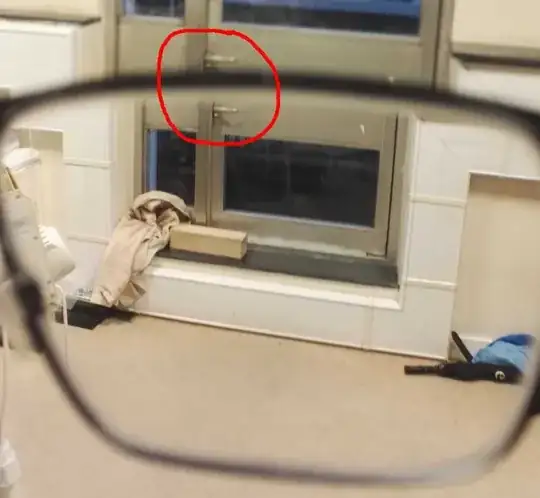

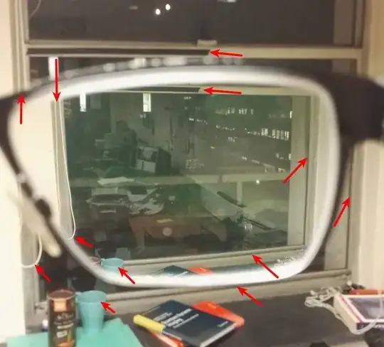

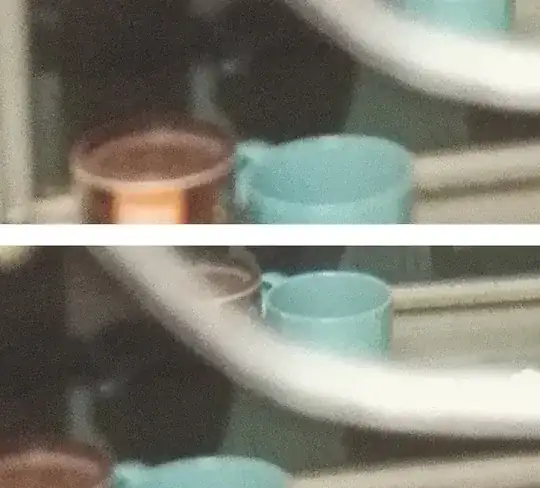

Yes. I am myopic and I see a slight double image along the edge of my glasses:
This means that the field of view inside the frame is bigger - zoomed out - than what it would be with the same frames but without the lenses.
Similarly, objects are slightly but perceptibly smaller than they are without the glasses, as is clear from the size of the mugs at bottom left of the image. Zooming in on them and putting the inside- and outside-the-glasses versions in direct contrast gives a clearer picture:
As has been pointed out, the effect is strongly dependent on your exact position with respect to the lens, and it is exaggerated in the picture above because the camera is artificially far from the lens. Visually, and with the glasses correctly worn, the effect is milder and it looks closer to the door handle below:
For the handle to look like this I need to be about 2m from the door; I have about 2.5 dioptres in that direction if my memory serves.
In practice, though, your field of clear vision is restricted to the frame of the glasses, which do not cover a lot of your peripheral vision. This means that in practice you have a much reduced line of sight compared with someone without glasses, or who uses contact lenses. Whatever amplification was gained through this mechanism - the optics of which have been described in detail in other answers - is completely lost to this, and it's something to be aware of with people wearing glasses - our field of view is rather restricted, regardless of whether one is myopic or hyperopic.

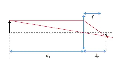

Here is the diagram for the unaided eye:
We know that $$\frac{1}{f}=\frac{1}{d_1}+\frac{1}{d_2}$$
and the magnification (minification) is
$$m = \frac{d_2}{d_1}$$

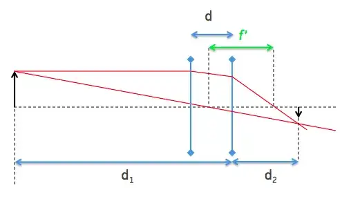

For the aided eye, the diagram looks like this:

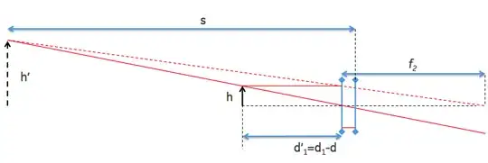

But it's quite hard to construct the optical rays properly without making a very confusing diagram. Therefore, I am going to split the analysis in two parts. First, I will demonstrate that the secondary lens produces a magnified image "further away" - and that this makes it possible for the weaker eye lens to focus. We can then compute the size of the image that the eye lens produces as though the other lens is not there:
I constructed a virtual image of height $h'$ at some distance $s$ from the eye lens. For this, I have assumed a focal length of the eye $f_1$ (not shown), and focal length for the auxiliary lens $f_2$. The distance of the virtual image is calculated from the usual lens formula:
$$\frac{1}{f_2}=\frac{1}{d_1-d}+\frac{1}{s-d}$$
Solving for $s$, we obtain
$$s = \frac{f_2(d_1-d)}{(d_1-d)-f_2}+d$$
This will be a negative number for the situation drawn, where we have a virtual image (namely, the object is in focus on the "wrong" side of the lens).
The height $h'$ of the virtual object is given (from simple geometry) by
$$h' = h \frac{s-d}{d_1-d}$$
Now we can consider the size of an object of height $h'$, at a distance $s$ from a lens with focal length $f_1$. The object will be projected on the retina in-focus (that's how we defined $f_1$ and $f_2$), and the retina is still at distance $d_2$ as before. It follows that the size of the object on the retina is now
$$h' \frac{d_2}{s} = h\frac{s-d}{d_1-d}{d_2}{s}$$
We can do a first order expansion to find out how this is different from the size for the unaided eye, which was $h\frac{d_2}{d_1}$.
$$\begin{align}m&=h\frac{s-d}{d_1-d}\frac{d_2}{s}\\ &\approx h\left(1-\frac{d}{s}\right)\frac{d_2}{d_1}\left(1+\frac{d}{d_1}\right)\\ &\approx h\frac{d_2}{d_2}\left(1-\frac{d}{s}+\frac{d}{d_1}\right)\\ &\approx h\frac{d_2}{d_1}\left(1-\frac{d\left(f_2-d\right)}{f_2 d} + \frac{d}{d_1}\right)\\ &= h\frac{d_2}{d_1}\left(1+\frac{d}{f_2}\right)\end{align}$$
And there it is. The last term represents the additional magnification due to the auxiliary lens. It is directly related to the ratio of the focal length of the auxiliary lens and the distance between that lens and the eye. So if you have a +2 diopter lens (focal length = 50 cm) at 1 cm from the eye, you get a 2% change in apparent size (size of projected image on the retina is 2% larger). That is noticeable, but not massive. Negative focal lengths will make objects appear smaller according to the same formula.

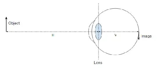

The eye forms an image on the retina just as any lens does:
Eye
The eye is actually a compound lens because the cornea and the lens both play a role in the focussing, but let's ignore the cornea for now and just treat it as a simple lens. In that case the magnification is:
$$ M = \frac{v}{u} $$
where $u$ is the distance from the lens to the object and $v$ is the distance from the lens to the retina. Assuming a normal, myopic and hyperopic eye are looking at the same object at a distance $u$, any difference in the magnification will be due to a different distance $v$.
Myopia can be caused by the eyeball being too long, in which case $v$ is larger than normal eye and the magnification is therefore greater. Such people see objects slightly larger than normal people do. However myopia can also be caused by a too powerful lens, and the eye length is normal. In that case a myopia sufferer would see objects the same size as a normal person. So there is no simple relationship between being short sighted and the magnification in the eye.
The same applies to hyperopia (long sightedness). It can be due to the eye length being too short, in which case the magnification will be lower than normal, or to the lens power being too small in which case the magnification is normal. Again there is no simple relationship.
Note that the eyeball size increases as we grow up, so even among normal sighted people the magnification changes as we grow up.
