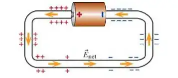

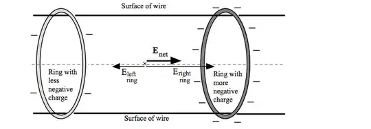

This is why in a wire making up a circuit, it's not that there's no electric field, just that the electric field is only due to rings of charge on the surface of the wire itself. There actually is a constant electric field throughout the wire (the argument for constant is pretty much the same: if there wasn't, some electrons would get pushed faster than others and build places of higher electron density, local electric fields that would speed some electrons up and slow others down until once again the electric field was constant everywhere), while the electrons inside the wire are evenly spaced out with the protons, creating no local electric fields.
I think these 2 images show this pretty well:
