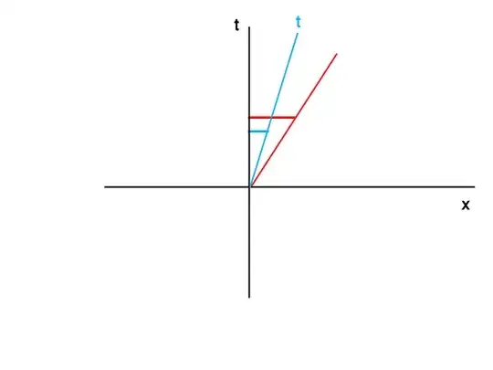

In a hindsight, here's another proof of rapidity being additive(without using velocity composition again).
Consider this spacetime diagram in which the black axis represents $S$, the blue is the worldline of $S'$ and we also have another object in relative motion to both of them(the red one).
Rapidity is defined as $\tanh \phi=v$ (where $c=1$), which is $\dfrac{x}{t}$, that is the hyperbolic angle between the time axis and the trajectory of an object. $S'$(blue) moves with $\tanh \phi_1$ and the red with $\tanh \phi_2$. We wanna know what is the rapidity of the red object in $S'$. it's simply the hyperbolic angle between the time axis of $S'$(blue) and the red worldline which is $$\phi_2 -\phi_1$$
Omar Nagib
