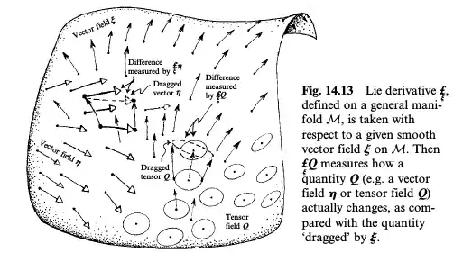

The Lie derivative can be thought of as the effect of being dragged by the flow of a vector field. For this purpose a metric can be thought of as a field of $\epsilon$-balls wrt to that metric. Lie dragging a metric at point $p$ along $v$ corresponds to displacing each point within the $\epsilon$-ball centered at $p$ by $v$. The Lie derivative then corresponds to the distorsion in the shape and size of the ball. The Lie derivative of a metric is 0 when $\epsilon$-balls are preserved by dragging. This means Killing fields must be divergence free.

This is an illustration from Penrose's Road to Reality:
