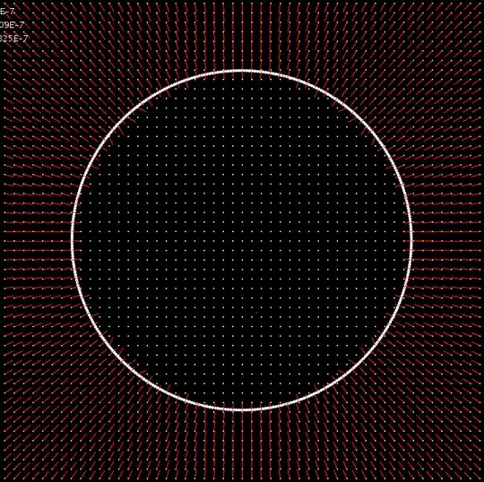

I wrote a quick field simulation to demonstrate this, but am getting a force inside the ring. The potential (-GM/r) is zero, but the force on a test mass (-GM/r^2) is non-zero.
I'll post the relevant segments of my code below and a few screenshots. Any ideas what's going on?
Each point in the field accumulates the felt gravitational force from all masses comprising the ring (which is a large set of very closely spaced point masses):

After this function has been executed for each point mass in the ring, the felt force at that location in the gravitational field is visualized.
Here's what the above code looks like: enter image description here

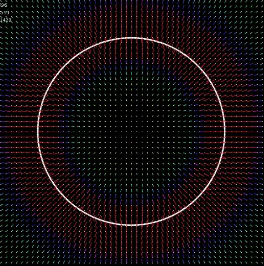

When I change the last 2 lines of code to:
fxAccum += nx*bigG*m.m/len;
fyAccum += ny*bigG*m.m/len;
The result is zero potential inside the ring, as expected:
Am I misinterpreting something here? A test mass inside of the ring will be pulled towards the edge. I thought Newton's shell method described zero gravitational force inside of the ring.

Newton's shell theorem relies on Gauss's law, which in $d$ spatial dimensions implies a $r^{1-d}$ force law. Since $d=2$, the force should fall off as $1/r$.
This explains why OP's first plot (with an $1/r^2$ code) fails to produce a vanishing interior force, while OP's second plot (with an $1/r$ code) produces a vanishing interior force.
(Btw, the second plot should not be interpreted as potential energy. For starters, recall that potential energy is a scalar, not a vector.)
