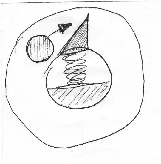

Here is another reason why a ratchet should not work: it would define a directional arrow of time even in thermal equilibrium.
To see this look at the modified ratchet in the graph (the triangular piece is attached to a spring). the brownian particle would move easier to the right as it can push the triangular piece down, but if it is at the right and tries to move to the left it will be stopped by the vertical surface (no way to push it down). Our intuition tells us that the particle then will circulate clockwise, even in thermal equilibrium. This defines an arrow of time: you can tell if a movie is shown in reverse. Which cannot be true.
