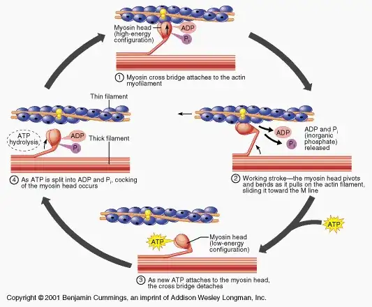

I'll go ahead and go the shocking route of saying, yes, you have done work.
But not on the bundle of grass (?), and not on the macroscopic level, only on the microscopic level.
We'll need some basic musculoskeletal biophysics to understand this (see diagram below). Your muscle cells contain interlaced strands of actin and myosin proteins. When your muscle is contracted, these proteins are constantly grabbing and pulling on each other, then letting go, then grabbing and pulling again. Each time they do this, they receive an input of chemical energy from an ATP molecule that allows for their repeated conformational changes. Each time they return to their original position, the energy they gained is transferred through a million molecular collisions with their surrounding cytoplasm into heat, analogous to a block repeatedly pushed up a hill and allowed to slide back down to a stop at the bottom, the potential energy it had transferred to heat. Each of those molecular collisions therefore represents a tiny bit of microscopic work (the actin/myosin complex exerts a tiny $W = \vec{F}\cdot \vec{d}$ on the molecules it collides with as it returns to its un-energized state). This work is not done on the bundle of grass, mind you, but on the various molecules constituting your muscle cells.
Actin and Myosin cycle
So, to sum up, when you hold an object over your head, you are using chemical energy to do work in a distributed microscopic way on the molecules of your muscle cells, but not in a macroscopic way, and not on the object itself, which does not gain any energy (since $W = \vec{F}\cdot \vec{d}$, and $d = 0$ for the object you're holding). This work that you do on your own molecules is responsible for the decrease in chemical energy that you experience, and, in turn, the increase in thermal energy (heat) that you can feel whenever you contract your muscles.
