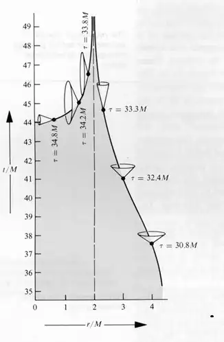

That infinite coordinate time means it hasn't happened yet, and it never ever will. This is what The Elephant and the Event Horizon is all about. Look at the Schwarzschild-coordinate picture from MTW. Imagine the light-cone is the elephant:
Note how the picture is truncated vertically? What that "suspiciously leaves out" is that at r=rs the elephant goes to the end of time and back, and is in two places at once. Draw a horizontal line at about t/M=45 and trace across from right to left. The elephant is there at τ = 33.3M, and it's there again at τ = 34.2M. IMHO this is nonsense, along with the idea that you can switch to say KS coordinates to get past this. When light stops an optical clock stops, and the stopped observer doesn't see it ticking normally "in his frame". Light is stopped, so he sees nothing, ever. See The Formation and Growth of Black Holes where Kevin Brown refers to the frozen-star interpretation. Most people don't know about it, but IMHO it's the only interpretation that makes sense and fits in with what Einstein said.
