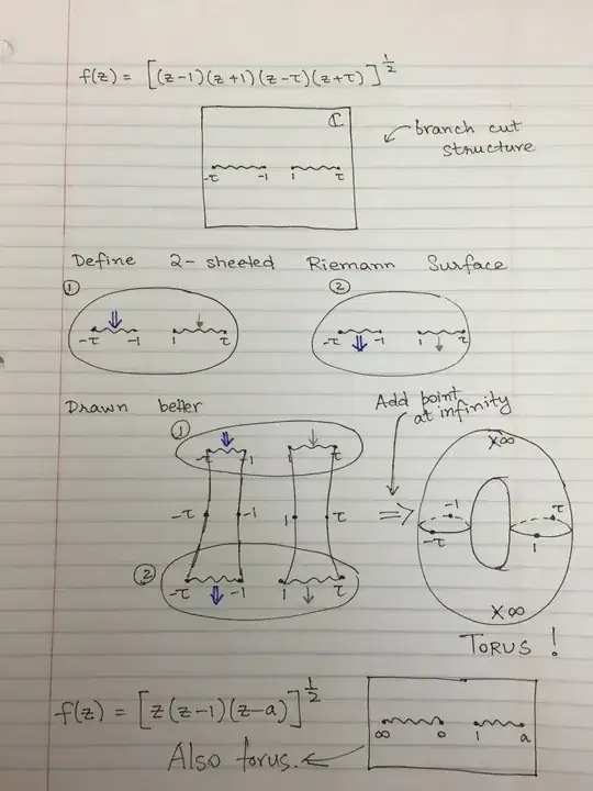

Now, let us describe the analogous procedure for the function $$ f(z) = \sqrt{ ( z - 1 )(z+1)( z - \tau ) (z+\tau) } $$ Here is a drawing that hopefully explains the structure. I believe its harder to explain in words.enter image description here
Let me explain a bit here. The first drawing the branch cut structure of this function on $\mathbb C$. In the second drawing I define a 2-sheeted Riemann surface as shown. The blue and white arrows indicate how one should move past the sheets when going through the branch cuts. In the third drawing I have simply placed the two sheets on top of one another so that the structure is clear. In the very last step, I have added the points at infinity for both the sheets. In doing so, the complex plane compactifies onto the sphere, leaving behind the torus!
This is how a torus can be understood as the Riemann surface corresponding to the function $f(z) = \sqrt{ ( z^2 - 1 )( z^2 - \tau^2 ) } $. Note that the only important thing here is the branch cut structure of the complex function. The function that you have written down also has the same branch cut structure once the point at infinity is included (which we did in describing the torus anyway). This is shown clearly in the last drawing above.
