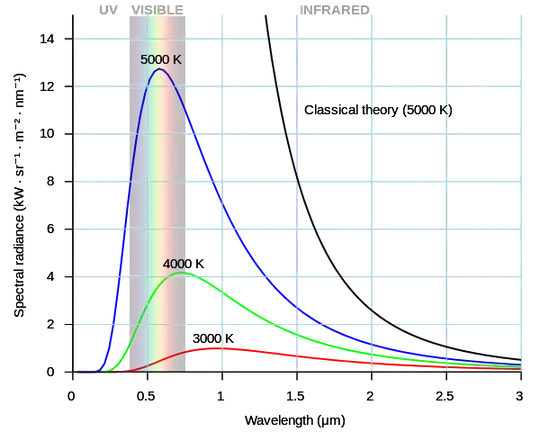

The temperature of blackbody could vary from 0 to $\infty$ (take our Sun and a much larger star as an example; you can assume both as a radiating blackbody but their temperatures are different). Based on this temperature, the spectrum they emit is different (see the figure). enter image description here
In your question the object's temperature has to depend on the source that is heating it up (here, the sun); the spectrum that this blackbody radiates is the same as the spectrum of sun, assuming a perfect blackbody.
Then if both your objects are exactly the same (mass, shape and material) their temperature also has to be the same. However, the difference in emissivity means difference in absorption as well, so, they have to be different in temperature and this does not depend on whether they are blackbody or not.
