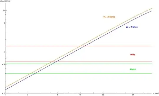

When we look at the full range of muzzle velocities from a list of cartridges, we find handguns/pistols range from ~304–515 m/s and rifles range from ~600–1392 m/s. I plotted the relative speed between two orbiting objects as a function of inclination (i.e., Equation 4 above) shown in the following image.
relative speeds
As shown, after even only ~3-4 degrees the speed differences exceed most handgun round muzzle speeds and after ~11 degrees nearly all civilian rifle rounds.
