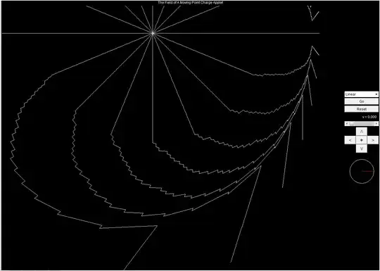

What exactly happens when the charged particle accelerates, and, after acceleration, why the radiation front behaves in such a peculiar manner, continuing to distort more and more the further it propagates. Here is a nice applet for studying the phenomenon: Field of a moving particle. And here is a snapshot from that applet where the particle has been moving, has decelerated, and is now stationary: [decelarating particle]. Note the weird shape of the field lines in the region where the news ''boss is moving'' is received.

However, these post fail to explain, in relativistic terms, why the field lines behave in such a peculiar way at the radiation front.
This is just Gauss's law. Gauss's law says that field lines only begin and end on charges. Since there are no charges at the radiation front, the field lines can't begin or end there; they have to connect up.
Let's study this animation
Let's say everything there happens in a large pool of water.
Let's especially look at the area left to the charge, where field lines move apart from each other. Water molecules are oriented in a certain way, and as the field strength decreases the molecules turn in a certain way, which means the charges of the molecules accelerate in a certain way.
When one plus charge accelerates to the west, nearby plus charges tend to accelerate to the east. That is the phenomenon called induction, or at least the basic idea is that.
Why is there a twist on a field line? There are accelerating charges near that area where the twist is. Those accelerating charges induce an electric field in that area.
If we are interested about the mechanism of the induction phenomenon, that can also be seen in the animation.
So now I hope we have explained everything that is happening in the animation, which includes radiation, as there was a charge that accelerated.
