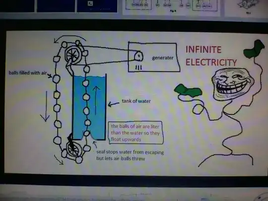

Can I make power (electricity ) using buoyancy see diagram. if this diagram is possible then how much power i get . I just need formula for upwards speed. enter image description here
The pressure at the bottom of the water tank is large. You have to push the balls in against this pressure - that is exactly as much work as you will get back.
No free lunch in nature. Sorry.
