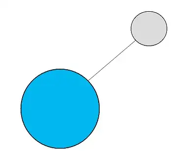

An earlier question was asked on what would happen if a rope was attached between Moon and Earth, but the question was more about the impacts in terms of geology.
We keep the same experiment setup :
Moon and Earth linked by a rope
Now let's add a guy holding the rope on Earth and an astronaut holding the other end of the rope, on the Moon. Since the distance between Earth and Moon is 384 000 km and that nothing can go faster than 300 000 km/s, what would happen if the Earth guy would pull on the rope. Would it take a little bit more than a second for the astronaut to feel the change in tension ? Does it mean that the rope has been somehow elastic during that 1 sec ?
