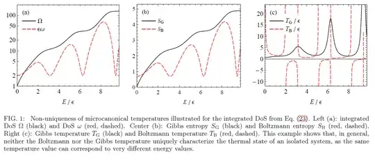

None of the answers above are correct. Matt Thompson's answer is close.
The OP asks for a mathematical proof that
if a negative-temperature system and a positive-temperature system come in contact, heat will flow from the negative- to the positive-temperature system
There is no proof for this statement because it is incorrect
In statistical mechanics temperature is defined as \begin{equation} \frac{1}{T} = \frac{\partial S}{\partial E} \end{equation}
i.e. a derivative of $S$. For $\it normal$ systems, like ideal gases, etc. $S(E)$ is a highly convex function of $E$ and there is a 1-to-1 relation between the system's macrostate and its temperature.
However, in cases where $S$ is not a convex function of $E$, $\frac{\partial S}{\partial E}$ can take the same numerical value at different energies $E$ and therefore the same temperature. In other words, $T$, unlike $E$ does --in general-- not uniquely describe a system's macrostate. This situation occurs in systems that have a negative Boltzmann temperature (detail: for a negative Boltzmann temperature $S$ needs to be non-monotonous in $E$).
An isolated system 1 with a negative Boltzmann temperature $T_B<0$ can have either higher or lower internal energy $E_1/N$ than another isolated system, system 2, that it gets coupled to.
Depending on which system has a higher $E_i/N, i=1,2$ heat flows either from system 1 to system 2 or vice versa, regardless of the temperatures of the two systems before coupling. For details, see
Below I have attached Fig. 1, taken from the arxiv version of this work to illustrate this fact.
PS
  1. I am not an author of any of the cited papers.
  2. Thermodynamics is compatible with the use of the Gibbs entropy, but not with the Boltzmann entropy. Showing this is a four line proof, see this Nature Physics paper Consistent thermostatistics forbids negative absolute temperatures. The Gibbs temperature (unlike Boltzmann temperature) is always positive, $T>0$.
  3. The attempt above by @Nathaniel at a purely thermodynamic proof of the OP's statement relies on the premise that $T<0$ is compatible with thermodynamics. This is not the case, see point 2. The proof given is invalid.
  4. For normal systems the distinction between Gibbs and Boltzmann temperature is practically irrelevant. The difference becomes drastic though, when edge cases are considered, e.g. truncated Hamiltonians or systems with non-monotonous densities of states. In fact, in most calculations in statistical mechanics textbooks the Gibbs entropy is used instead of the Boltzmann entropy. Remember calculating "all states up to energy $E$" instead of "all states in an $\epsilon$ shell at energy $E$"? That's all the difference.
  5. There is a whole series of attempts to publish comments on the Nature Physics article by Dunkel and Hilbert, but all got rejected. These all follow the pattern of trying to create a contradiction, but none were able to punch a hole into Dunkel and Hilbert's short mathematical argument.
