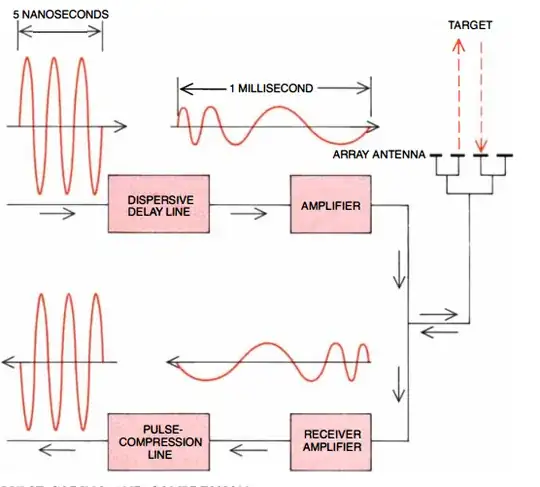

As it turns out, however, the radar technique is not quite the same, apparently because the peak-power restrictions hold all the way to the antenna. What they do is something rather clever: they stretch the pulse using a dispersive delay line and then they amplify it, and they send it off uncompressed to interact with whatever planes or ships or aliens are out there. The echo will return at a much lower intensity, but crucially it will retain the original chirp, which means that you can still compress it, without running the risk of having unreasonable powers in your wires or your antennas.
Source: Phased-array radars. E. Brookner. Scientific American 252, Feb. 1985, pp. 94-102..
This is a beautiful technique, and at heart it depends only on the linearity of the interaction between the radar pulse and whatever it's reflecting off, and the fact that these reflections will preserve the phase of the pulse. As such, it should be perfectly possible to apply it to a fair number of optical setups. This might be somewhat hard to apply in ultrafast physics, since we tend to be interested in nonlinear phenomena, from the perturbative to the extreme, but even then a nonlinear interaction is likely to retain a coherent trace of the chirp which could then be compressed into something useful.

In radar, chirp (LFM - linear frequency modulation) is used to stretch the pulse so that the received energy is large enough for detection while having a large coherent bandwidth commensurate with the desired range resolution. There are two ways of detection, the so-called "stretch processing" that is just a correlation receiver using a homodyne mixer, the other is a matched filter. If the target is further out than the pulse length then matched filter is the only way to go. "Stretch processing" (homodyne mixing the return with the reference transmitted signal) followed by a Discrete Fourier Transform as filter bank is used exclusively if the pulse length is much longer than the roundtrip delay. This technique is also very common in synthetic aperture radars to create a high resolution map, it is also used in discrete stepped frequency form.
What makes chirp often less desirable than other potential waveforms is the coupling of the range measurement with the Doppler shift if the target or parts of the scenery is moving. Another problem of chirp is its obvious sensitivity to time/frequency linearity and FM/PM noise as its measured quantity is frequency shift. Note that the generation of a high quality linear chirp over a broad bandwidth is not a simple matter even at microwaves when using a voltage controlled oscillator. A varactor is a notoriously nonlinear device and the oscillator has to be placed in a negative feedback phase or delay locked loop so the frequency sweep be linear. This linearization slows down the potential sweep rate.
In principle, all of this can be done with LIDAR as long as the source can be kept coherent over the observation interval but that is not easy if the target range is more than a few microseconds (150m/microsec), see, Vasyl Molebny, Gary Kamerman, Ove Steinvall: "Laser radar: from early history to new trends" Proc. of SPIE Vol. 7835 783502-29; Pierrottet, D., Amzajerdian, F., Petway, L., Barnes, B. and Lockard, G., “Flight test performance of a high precision navigation Doppler lidar”, Proc. SPIE 7323, 732311 (2009). There are other interesting applications that does not require very long coherence, for example as an instantaneous spectrum analyzer of a very wideband microwave or mm-wave signal.
