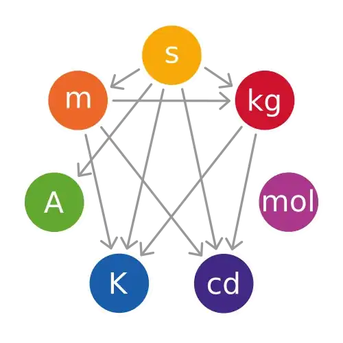

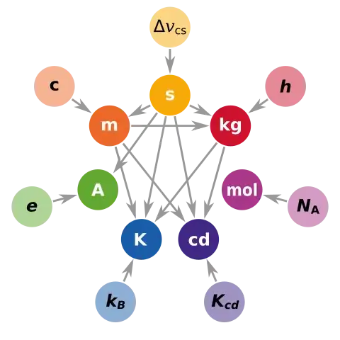

Metrologically speaking, on the other hand, it is very important to keep track of how each standard depends on other base units, because that has a profound influence on how precise each standard can be. For example, the standard for electrical current depends on one mass standard, which is based on the artefact kilogram; this means that one can never really measure SI currents to a better precision than the nine significant figures of stability in the IPK.
The current SI units have a fairly complex web of interdependences, shown on the left. This will be replaced within a few years by the 'new SI', with an even more interconnected graph shown on the right.
Image source 1, Image source 2
