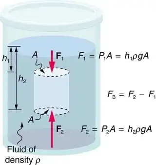

First of all look at the attached picture,
if $F_1+mg>F_2$ , where $mg$ is the weight of the cylinder,
then the cylinder sinks. It does not matter what is the cylinder made of. It can be made of a mixture of various atoms of all kind of weights.
In order to disproof your theories we can assume the cylinder (not the jar that contains the liquid) is made of aluminium ($\rho_{Al}<\rho_{Hg}$) and it is empty. You fill it with uranium ($\rho_{U}>\rho_{Hg}$) and you let it sink in mercury ($Hg$). The cylinder will sink despite the fact the mercury is in contact only with the aluminium which is a few times less denser.
