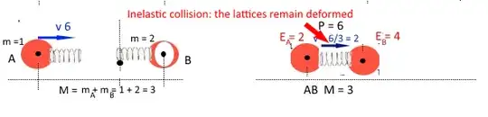

If a body is not elastic (sad ball) the KE will deform the body and this change is irreversible, the KE will be transformed into heat, sound etc. and will not be available anymore as mechanical energy. In this video you can see the enormous difference between a sad and a happy ball of same mass and momentum. If the concept of impulse is not clearly explained there this answer can be of great help
Why is mechanical energy converted as total energy is conserved in inelastic collision? Kinetic energy is transformed into an exactly equal quantity of other forms of energy in inelastic collisions, therefore the total energy of the system does not change: KE is not conserved whereas momentum is, but energy in general is conserved anyway
