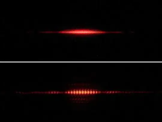

Here is an experiment example. Say I did a variation of the double-slit experiment. In this variation, instead of having one source that emits electromagnetic radiation from behind the two slits, there are two sources, one at each slit. In essence, I'm performing two single-slit experiments right next to each other projecting onto the same surface. Instead of firing only one photon at a time, each source fires a single photon at a time, both sources firing at the same time.
I have two predictions for what would happen. One for if there is one large electromagnetic field that fills all of space, and one for if each electromagnetic field is separate.
The top image is my prediction of what the result would look like if each field is separate, and by implication the waves do not interfere. The bottom image is my prediction if there is a single electromagnetic field and the waves in the field can interfere with each other.
Predictions

Now your thought experiment with the two slits is irrelevant to the above discussion, as it will depend on the boundary conditions of the experiment, whether the quantum mechanical solution which gives the probability of finding the photon on the (x,y) of a screen at z will show an interference. Two independent laser beams can show interferences, depending on the boundary conditions.
