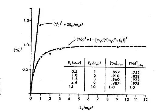

In an experiment published in 1964, electrons were accelerated to a large voltage difference (up to 15 million volts) and the speed of electrons was directly determined. no matter how much accelerating voltage is increased, the speed never quite reaches or exceeds _c_ enter image description here
find this image here in this link
So from the chart in this image $( \frac vc )_{obs}=1 $ at $15MeV$ , hence we may say that at 15 MeV the speed of electron (rounded off) was equal to c. or better to say that limit $ v → c $

Unfortunately this:
$\large{m= \frac {m_0}{\sqrt{1-\frac{v^2}{c^2}}}}$
... is a stubborn and common misconception.
In reality it's the momentum $p$ that is relativistic:
$\large{p= \frac {mv}{\sqrt{1-\frac{v^2}{c^2}}}}$
Or as Albert Einstein wrote in a letter to Lincoln Barnett on 19 June 1948:
It is not good to introduce the concept of the mass $M = m/\sqrt{1 - v^2/c^2}$ of a moving body for which no clear definition can be given. It is better to introduce no other mass concept than the ’rest mass’ m. Instead of introducing M it is better to mention the expression for the momentum and energy of a body in motion.
