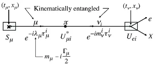

  3. There is a way to make a rigorous analysis (whole thing at arXiv:1110.3047), and it ends up agreeing with the usual formulation at first order in $\Delta m^2_{i,j}$. It requires that you consider an experiment in the rest frame of the particle that decays to produce the neutrino (and a charged lepton). You define that decay as occurring at space time point $(0,0)$ and compute the amplitude for a neutrino in mass state $i$ to be detected at space time point $(x_\nu, t_\nu)$ in coincidence with the charged lepton being detected at space time point $(x_l, t_l)$ (both also written in the rest frame of the decay particle). Then you notice that the propagators for the two leptons are kinematically entangled. Sum the amplitudes coherently (because the mass state of the neutrino is unobserved). Using the fact that the neutrinos are ultra-relativistic approximate to first order in $\delta m^2_{i,j}$ and drop all terms that don't affect the phase-differences (because neutrino mixing only depends on the phase differences). Somewhere in there was a boost back to the lab frame and a cute calculation of how L-over-E is invariant under the boost: $\frac{L^0}{E^0} = \frac{L}{E}$. The result should be the one we usually give, only now we've dealt with this cute little puzzle.
    Here's an image from an earlier talk he gave on the same subject which shows the whole process on which the calculation is performed: enter image description here
