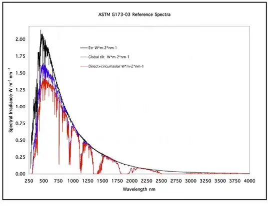

I have the AM 1.5 spectrum http://rredc.nrel.gov/solar/spectra/am1.5/
Which gives spectral irradience in units of $\frac{W}{m^2 nm}$ vs wavelength in $nm$. For my purposes I need this spectrum in terms of $\frac{W}{m^2 eV}$ vs $eV$.
Converting the x-axis is relatively straightforward: $$\varepsilon \ [eV]=\frac{hc}{\lambda \ [nm] \ q}\times 10^9$$ Where q is the electron charge and h,c are in their SI units. However I can't seem to figure out the correct y-axis conversion. I would expect it to be similar in magnitude to the black body spectrum obtained via plancks law:
$$ I(\varepsilon) = \frac{2 \pi}{h^3 c^2} \frac{\varepsilon^3}{\text{exp} \left( \frac{\varepsilon}{kT_{sun}}\right)-1} \times q$$
How can I convert this spectrum between $\frac{W}{m^2 nm}$ and $\frac{W}{m^2 eV}$ ?

The technique is exactly the same as a change of variables in a probability distribution.
Let's denote the flux (power per unit area) per unit wavelength as $F_\lambda$, and the flux per unit energy as $F_\varepsilon$. Then we simply have $$ F_\varepsilon = F_\lambda \left\lvert \frac{\mathrm{d}\lambda}{\mathrm{d}\varepsilon} \right\rvert. $$ All you need to do is express wavelength in terms of energy for light. You were getting at this in your x-axis conversion, except your conversion there is wrong confusing. Electron-volts are units of energy, plain and simple; just use the relation $\lambda\varepsilon = hc$, where conveniently $hc = 1.240\times10^3\ \mathrm{eV\cdot nm}$.
