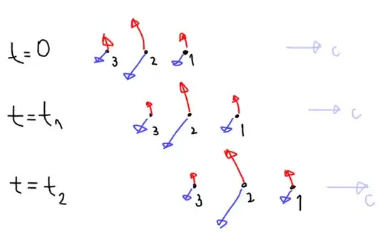

1- Does it mean a single photon moves and carries fields of varying magnitude? Therefore we experience different electrical and magnetic field depending on at which position we encounter the photon? So by chance, if a point object is just at the place where E=B=0, photon may just pass through without doing anything? I tried to draw it as follows, in case I cannot make myself clear by words. enter image description here (picture 1)

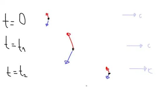

2- Or does it mean, photons travel in groups and their sequence forms a sinusoidal shape. And the whole group goes with c, as in the following clumsy drawing (of course it is drawn discrete but I mean if this image was continuous): enter image description here (picture 2)
I think that all notes I encounter mean the 'picture 1' I have drawn. But it just do not feel right to me with my current knowledge, since varying fields of single photon means effect of a photon to a point charge depends on which phase photon meets the charge although photons were supposed to have a constant energy to give off. And also, if we look at the field distribution with a ray of photons, that would make the field move even faster than c, since photons carry their wave with c but the wave they carry also seems like propagating as it changes with time. Would you explain this mechanism to me, what proof do we have to say this actually happen instead of picture 2 I have drawn? Why do we rule out possibility of picture 2? (the question is not duplicate specifically because this part, and that it tries to relate photons propagation with it)
