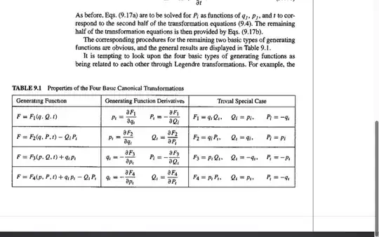

I have the following CT $$Q_1(q_1)$$ $$Q_2(q_2,p_2)$$ $$P_1(p_1,p_2,q_1,q_2)$$ $$P_2(p_2,q_1)$$
Where I am just indicating what old coordinates are used in the new coordinate functions. So when looking through Goldstein (and any source online), there are 4 different generating functions, as given in the table.
I am really unsure of how to determine which to use, let alone going about finding it.

To perform the canonical transformation, we may be able to introduce the function $F=F_1$, where
$$P_i \dot{Q}_i-K+\frac{dF_1}{dt}=p_i \dot{q}_i-H$$
or we could introduce $F=F_2-Q_iP_i$, and we thus have
$$-\dot{P}_i Q_i-K+\frac{dF_2}{dt}=p_i \dot{q}_i-H $$
Similarly for the generating functions for $F_3$ and $F_4$.
Now that we understand their differences, we have to ask how we use them. What you use is based upon what you know. If I want to find $F_1$, I integrate $p_i$ with respect to $q_i$ and $-P_i$ with respect to $Q_i$, and combine the result to find the whole value for $F_1$. A similar process follows for the identities for $F_2$, $F_3$, and $F_4$. Now, if I have the opposite problem--namely, I have $F_1$, and I want to find the coordinates and/or momenta--then I take the partial with respect to $q_i$ to find $p_i$ and the partial with respect to $Q_i$, take the negative, and I find $P_i$.
If I understand your question correctly, you have a set of $Q$'s and $P$'s, and you want to find $F$. You can pick whatever $F$ you want--you just need to change the definition of the generating function as given above.
