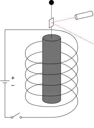

The Einstein–de Haas effect, if I understand it correctly, demonstrates a deep relationship between the intrinsic angular momentum (spin) and the magnetic moment of a particle; For this reason when a cylindrical ferromagnetic material is placed in a external magnetic field, it will begin to spin because enough angular momentum was localized in the cylinder to measure a macroscopic spin; but this is only possible because enough the magnetic dipole moments in the cylinder were aligned due to the external field. This makes sense and its very intuitive but my question is this: if we removed the cylinder entirely and constructed the coil with ferromagnetic material would the coil begin to spin or are there fundamental laws which require that the necessary fields to do so are canceled, making the spin of the coil impossible?

Almost. Whereas I guess the E-de-H effect does require the magnetic moment to be along the spin direction, what the effect is really used to show is that an electron spin flip imparts $\hbar$ of macroscopic angular momentum to the cylinder. Just because we know that the electron is a two state object transforming under rotation by the s=1/2 representation (ie: 2x2 matrix) of SU(2), does not mean that we know that the expectation values of the dimensionless rotation generators are equal to mechanical angular momentum divided by $\hbar$.
The spins of all the electrons in the cylinder are aligned by the magnetic field from the coil. Then the field is reversed so the electron spins line up the other way. This imparts $\hbar$ of angular momentum to the cylinder for each electron flipped. The effect on the cylinder is very small, so the flipping is repeated many times at the torsional resonant frequency of the cylinder on the fiber. This pumps the resonance up to some maximum deflection (measured by the light beam reflected off the mirror). Using the fiber spring constant, the fiber damping coefficient, and the moment of inertia of the cylinder you can calculate how much angular momentum per flip is being transferred to the cylinder. Given the number of flippable electrons in the cylinder then yields $\hbar$ angular momentum per electron flip.
A similar measurement has been made for spin 1 photons that demonstrates a circularly polarized photon carries $\hbar$ of mechanical angular momentum. A known number of circularly polarized photons are directed onto a black disk. The disk acquires an angular momentum which is measured by using its angular rotation speed and moment of inertia.
Only the electron and photon spins have been directly shown to carry mechanical angular momentum. However, it would be weird if other particles' spin did not also carry $\hbar$. For example, a proton and electron can form a hydrogen atom in a j=0 (singlet) state. Here the proton and electron spins are in opposite directions. If the mechanical angular momentums did not cancel, we would have a singlet state with angular momentum (pointing in what direction??).

Yes. The Einstein-de Haas effect demonstrates that "spin angular momentum is indeed of the same nature as the angular momentum of rotating bodies as conceived in classical mechanics". Some people will tell you that electron spin is in no way classical and is spooky quantum magick, but this 100-year-old experiment suggests otherwise.

If we removed the cylinder entirely and constructed the coil with ferromagnetic material would the coil begin to spin?
Darn it, I don't actually know. The proof of this is in the pudding, in the actual experiment, and I can't find a reference. But I think the answer is yes, see for example this where the galvanometer coil gets an angular impulse. I'm thinking your ferromagnetic coil would only begin to spin when you turn the current on. It jerks round a bit. It doesn't keep spinning. Then when you turn the current off it jerks back round to its original position. You can see something like this occurring when you turn a wall-mounted hose reel on and off. But I'm not sure whether this counts as the Einstein-de Haas effect.
