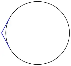

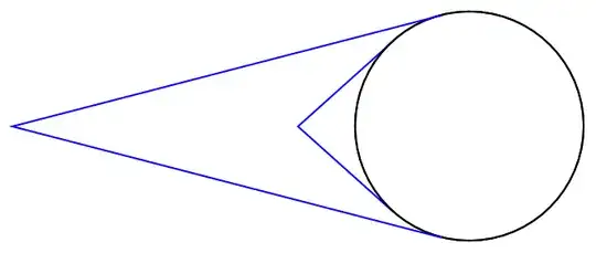

The second image, referenced here, was taken by Suomi NPP from an altitude of ~830 km, from where the perspective looks roughly like this,
where it is obvious that the wide field of view is only possible because of the fisheye lens, with its associated distorsions.
