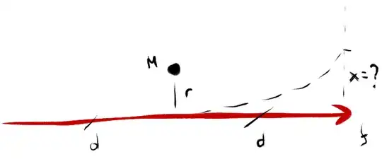

Consider a light beam, initially having a straight line trajectory. If I put a mass $M$ at distance $r$, trajectory will bend slightly towards the objects side. If I put the mass even closer, light might even hit the mass with following a 'death spiral' path. At one specific mass and distance, one can even make light orbit the mass forever if no other interaction exists (or am I mistaken about that?). How do we anticipate which happens?
To discuss on more specific terms: Say there is a wall at a distance $2d$ from the source, at the middle point $d$ there is an object of mass $M$. We send light with frequency $f$, and the straight line photons would follow without gravity has closest distance of $r$ to the object. How much would light would deviate from its final destination, due to gravity?

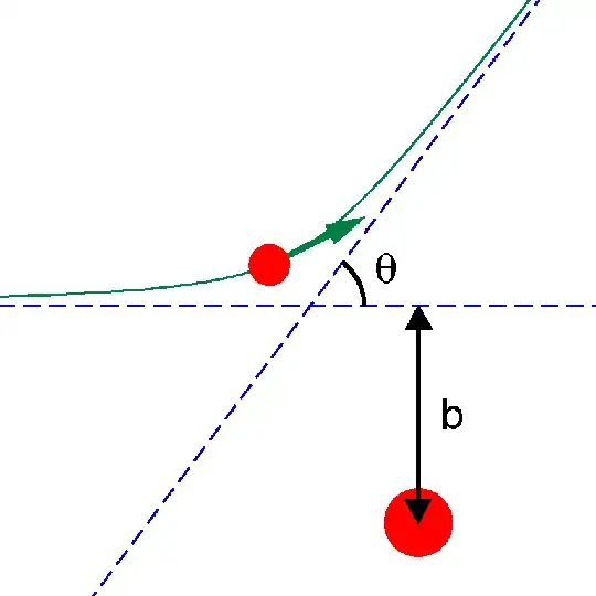

Yes, you can calculate light trajectories in gravitational fields. The equation is $$ \left( \frac{1}{r^2} \frac{\mathrm{d}r}{\mathrm{d}\theta} \right)^2 = \frac{1}{b^2} - \left(1- \frac{2M}{r}\right)\frac{1}{r^2}$$
Here, $r$ is the distance between the light beam and the massive object, $\theta$ is the angle of the light beam, $M$ is the mass of the object, and $b$ is the impact parameter (the minimum distance between the light beam and mass if there was no bending). See the image below.
Integrating over this equation gives the total deflection of the light during its passage near the massive object. As given in a comment, it is:
$$\Delta \theta = \frac{4MG}{Rc^2}.$$
