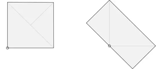

Because the integrand is periodic, the domain can be changed from $A$ to $A'$ like so:
Rectangles A and A'

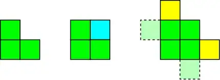

The next diagonal is done like so:
Fill in R11, then R02 and R20
Here the turquoise square means that we fill in $R_{1,1}$ using the formula for $R_{n,n}$. The yellow squares indicate an appliation of the recurrence relation to determine $R_{2,0}$ and $R_{0,2}$. The dotted squares also indicate resistances we had to determine by symmetry during the previous step.

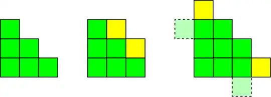

The diagonal after that is done similarly, but without the need to invoke the formula for $R_{n,n}$:
Fill in R12 and R21, then R03 and R30
Repeatedly alternating the two steps above yields an algorithm for determining every $R_{m,n}$. Clearly, all are of the form

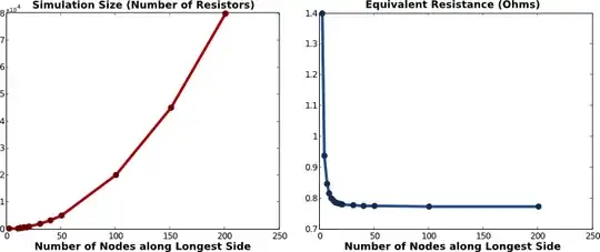

Successive Approximation! I'll start with the simplest case (see image below) and add more and more resistors to try and approximate an infinite grid of resistors.
Simulation results
Mathematical derivation:
$$R_{m,m}=\frac 2\pi \left( 1 + \frac 13 + \frac 15 + \frac 17 + \dots + \frac 1 {2m-1} \right)$$
