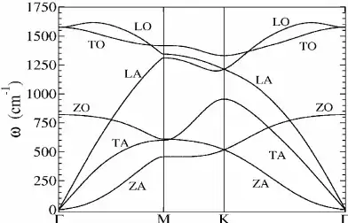

First of all, it is perfectly possible for goldstone modes to have non-linear dispersion relations (e.g. a quadratic $k^2$ dispersion), see more discussion here.
Additionally, acoustic phonons are not always linear in $k$, in fact graphene has an acoustic phonon that disperses quadratically as $k^2$ rather than linear in $k$. This is apparently a generic feature of the out-of-plane polarized acoustic phonons in quasi-2D layered materials.
It is important to point out that the other acoustic phonons have linear dispersions.
In the case of graphene, the quadratic dispersion of the ZA mode seems to come from the rotational and reflection symmetry of the system, more discussion can be followed in this paper.
From "Ab Initio Study of the Electronic and Vibrational Properties of 1-nm-Diameter Single-Walled Nanotubes"
