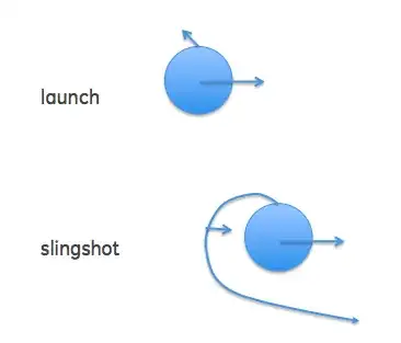

Speculatively building on the answer given by @fibonatic here:
If you were instantly "far from earth", then your argument for launching at night makes sense for long distance travel. But if you consider that you are orbiting Earth for a short while as you gain altitude, you actually "sling shot" around the earth by starting on the day side - the gravitational pull from the earth accelerates you in the direction you ultimately want to go, and you actually end up overtaking the earth:
This means that the correct place to launch will be determined not just by your instantaneous velocity at the point of lift-off, but also by the rate of climb that you can sustain.
