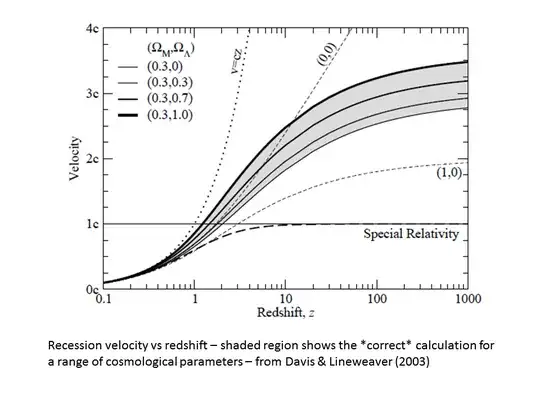

The relationship with observed redshift is much more complicated and depends on the cosmological parameters that determine what happens to the universe between when the light was emitted and when it is received. You can find it as equation (1) in Davis & Lineweaver (2003); it depends on the matter density, dark energy density and the current Hubble parameter. Davis & Lineweaver perfomr some calculations and provide the plot below. At small distances, the approximation $v = cz$ works well, and it was actually a relationship between redshift and distance that was originally discovered and referred to as Hubble's law.
Recession velocity vs z from Davis & Lineweaver (2003) The redshift caused by the expansion of the universe is experimentally indistinguishable from the doppler shift caused by a recession velocity. However, at large redshifts, the recession velocity you would calculate from an observed redshift, even taking account of the special relativistic formula for doppler shift, would not yield the correct recession velocity on the left hand side of Hubble's law. Indeed the recession velocity can exceed the speed of light e.g. How Are Galaxies Receding Faster Than Light Visible To Observers?
A modern day "Hubble's Law" plots distance (or apparent magnitude of a standard candle) against $cz$ and it is curved at high redshifts. Note though that $cz$ can and does exceed $c$ and this should not be directly interpreted as a velocity.
