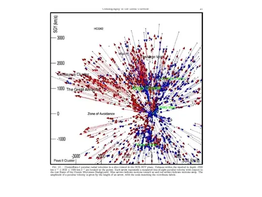

Here is one visualisation from the paper. It shows peculiar velocities (with respect to the Hubble flow) for galaxies within about 20 Mpc. The view is confined to the 2D X,Y plane defined by our Galactic plane. Each point represents a galaxy and the axes are its position expressed in terms of a velocity (with $H_0 = 74$ km/s per Mpc). The arrows represent the amplitude of the line of sight peculiar velocity. Blue is towards us and red is away. The length of the arrow gives the amplitude of the velocity on the same scale as the axes.
You can immediately see there is loads of structure on these scales. The velocity field is most definitely not a straightforward Maxwellian or power law. The local group of galaxies is moving at around 600 km/s with respect to the CMB, there are bulk flows and various "attractors". Such flows and anisotropies appear to exist on scales at least out to 100 Mpc (e.g. Lavaux et al. 2010). Typical peculiar velocities are $\pm 300-500$ km/s.
Line of sight velocity field from Courtois et al. (2013)

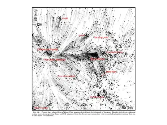

Then here is an even more awesome view, which is a reconstructed view of the 3D velocitiy field (in the X,Y plane of our galaxy). Now each galaxy has an estimate of its 3D velocity shown and reveals the flows that are present in a more persuasive image. The paper also contains similar images in the X,Z and Y,Z planes.
3D reconstructed velocity field.

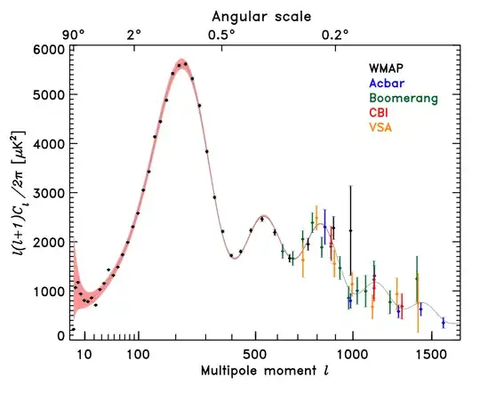

Now, the CMB itself is incredibly uniform with deviations of only 1 part in 100,000. We are able to measure these deviations (in the form of temperature fluctuations relative to the mean temperature) using instruments like WMAP, Planck, etc. The useful information that we extract from the CMB is in the form of a power spectrum, $P(k)$, which tells us how large the fluctuations are over different angular scales. Taking the temperature deviation field and decomposing it into spherical harmonics (since the CMB is projected on the sphere of the sky), we compute how much power there is in each mode. enter image description here
Roughly speaking, cosmological simulations use the information from the CMB to generate a distribution of particles with the same statistical properties.

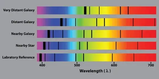

There is a kind of speed distribution law, in that the further the objects are away from each other, the faster their relative velocity, in general terms.
You can see the speed distribution based on Doppler shifting of spectral lines, in the diagram above.
