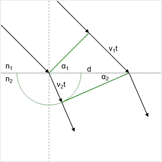

Refraction through wavefront reconstitution
Diagram 1, Wavefront reconstitution
The diagram also has a factor 'd' for the width of the propagating wavefront, but this width does not affect the refraction angle, and accordingly in the equations the factor 'd' drops away.

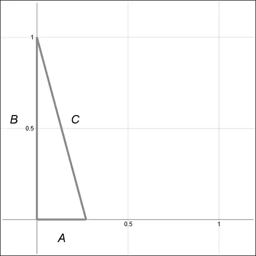

Derivative of length of hypotenuse
Diagram 2 (animated GIF), relation between length of hypotenuse C and opposite side A
In preparation I derive an expression for the rate of change of the hypotenuse C's length as the length of the opposing side A changes:
$$ \frac{dC}{dA} = \frac{d(\sqrt{A^2 + B^2})}{dA} = \frac{A}{\sqrt{A^2+B^2}} = \frac{A}{C} \tag{2.1} $$
with the intermediate steps removed:
$$ \frac{dC}{dA} = \frac{A}{C} \tag{2.2} $$

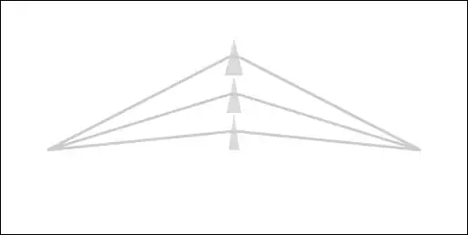

In addition to the case of a mirror curved to ellipse shape there is also the multiple prisms case depicted in diagram 4
Schematic representation of an imaging fresnel lens
Diagram 4, a set of prisms
In Diagram 4 there are three paths available for the light to go from a single start point to a single end point, each with different duration. At the end point we observe the light coming in from three directions; the light has taken all three paths. The light has taken the path with the least amount of time, and the path with the most amount of time, and the in-between path.
Diagram 4 illustrates that Fermat's stationary time criterion is actually very permissive. It is only in some rare cases that Fermat's stationary time provides sufficient constraint to give a unique solution.
