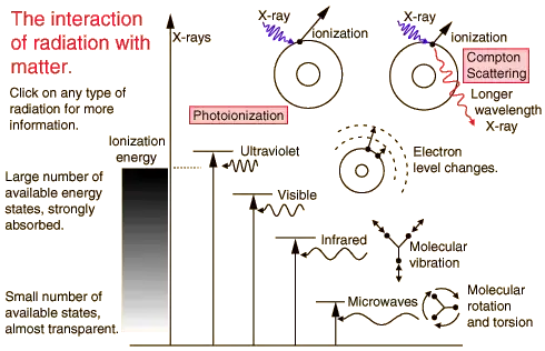

Checking on the special relativity part first: What does transparency mean to a single photon?
radiation
A disk rotating at such speeds will no longer be transparent to the photon, imo, as the probability of finding an available quantum state will be very high (depending on the radius of the disk) but the quantum states of the molecules composing the disc will also be stressed to new quantum mechanical solutions.
I agree with this exposition about the behavior/transformation of solid bodies at relativistic speeds.
So the disk will be non transparent to light, as it is for photons, just from the effects of special relativity.
