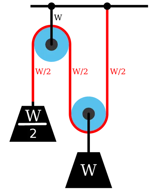

With regards to intuition, it might help to think about situations of mechanical advantage.
For example, consider a simple pulley system.
modified from "Pulley1a". Licensed under Public Domain via Commons - https://commons.wikimedia.org/wiki/File:Pulley1a.svg#/media/File:Pulley1a.svg modified from "Pulley1a". Licensed under Public Domain via Commons - https://commons.wikimedia.org/wiki/File:Pulley1a.svg#/media/File:Pulley1a.svg
You can work out using force that the weight $W/2$ balances the weight $W$. Since they are balanced, we could grab the weight $W/2$ and pull downwards on it with essentially zero effort, lifting the weight $W$ up.
In doing so, we put effectively zero energy into the system. However, work is being done on weight $W$ since it is rising. That energy must come from weight $W/2$. The force of gravity on weight $W/2$ is half as much as on weight $W$, but weight $W/2$ falls twice as far. Thus, the total energy change (work done by gravity) is the same magnitude. This is what allows the pulley to balance, and it shows that the work formula should have force*distance in it.
