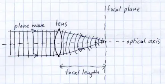

Plane wave hitting a lens face on
When a plane wave hits a lens face on, the lens focuses it to a point on the optical axis, at the focal distance of the lens.

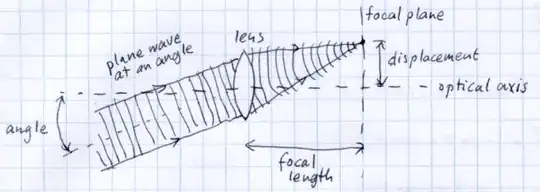

Plane wave hitting a lens at an angle
However, when the plane wave is incident at an angle, the focus is still at the focal distance, but displaced from the optical axis. This is how a lens transforms "angle" to position.

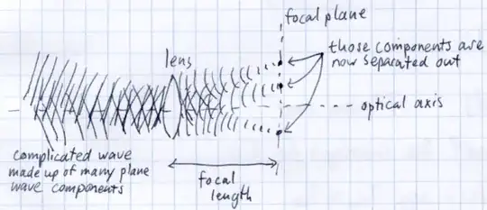

1-D Fourier transform using a lens
So if you have a more complicated beam made up of many spatial frequencies (which, as I said, are just plane waves), they are all focused to separate points in the same plane on the other side of the lens, one focal distance away. This is why we say it computes the 2-D Fourier transform of a monochromatic light beam. In fact, in the 1970s, when computers weren't so fast, people actually experimented with using lenses to calculate Fourier transforms instantaneously!
