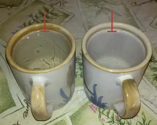

Edit: I did the experiment:
  1. I poured boiling water into two ceramic mugs
  2. I put a layer of canola oil on top of one mug
  3. I took a picture:Two mugs of hot water, left one with layer of oil

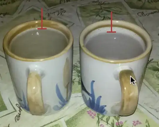

  4. I waited an hour, feeling the temperatures of the two mugs
  5. I took another picture, and compared the temperatures:Same mugs after waiting an hour
Nope: didn't have a thermometer, didn't weigh them. We're talking basic. But here are the results:
  1. Starting after the first five minutes, the mug with oil on top was consistently warmer
  2. The mug without oil lost about 4% of its water to evaporation
  3. Final temperature of right mug was a bit over room temperature
Water has a heat of vaporization of 540 calories per gram. So, losing 4% of the water means that the right mug's contents lost about 22 calories per gram to evaporation heat, meaning that evaporation alone lowered the temperature by 22°C. If the water temperature went from 90°C to 30°C, then about 1/3 of the lost temperature was due to evaporation.
That's actually less than I expected. However, note that this was a full hour of cooling, down to close to room temperature. The rate of evaporation is strongly temperature-dependent, so I would expect that initially the heat loss was mostly evaporation, but that ratio quickly fell with the temperature. (I edited the initial sentence of this answer to be closer to reality.)
