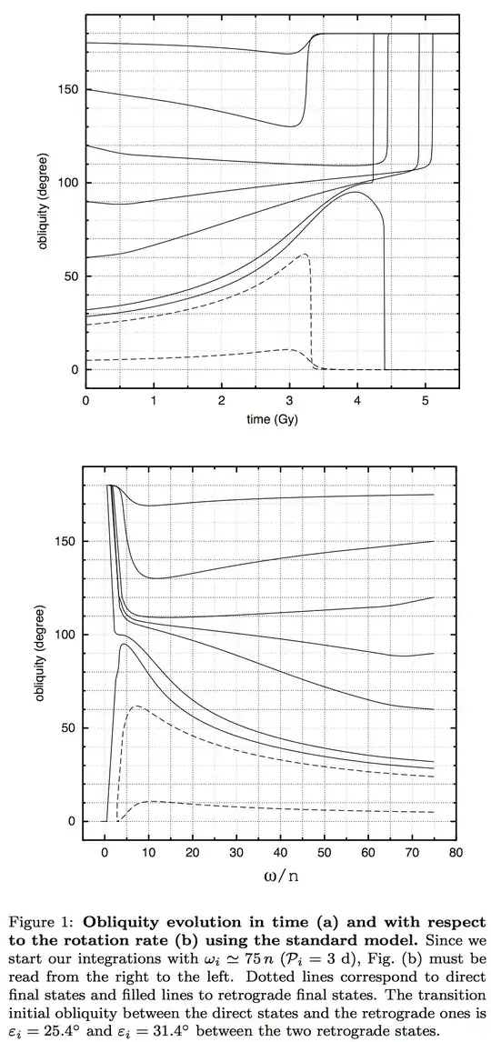

Unfortunately, it's very hard to work out the details. This is because on the scale of billions of years, the evolution of the solar system is chaotic, with tiny changes in initial inclinations or positions leading to radically different results after billions of years. As an example, take a look at this figure from `Long term evolution of the spin of Venus - II. Numerical simulations', A.C.M. Correia et al, showing the evolution of the Venus spin over time. It's pretty wacky, especially near 30$^\circ$.
