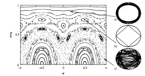

In order to get yourself acquainted with such concepts, I suggest looking into 2D dynamic billiards. These models are of great interest because their dynamics are solely defined by the shape of the boundary, circular, ellipsoid, stadium etc. Now an interesting example to showcase here would be the oval shaped boundary (note circular and ellipsoid billiards are regular because of their symmetries):
In the above image (by Tureci, Hakan, et al. 2002), on left you see the poincaré map2 of the 2D oval billiard (with specular reflection), and on the right you see 3 examples of different regimes of the system. This is a perfect example showcasing a system that admits only locally integrable regions. Case a) corresponds to a quasi-periodic orbit, only marginally stable. Case b) shows a stable periodic orbit surrounded by a stable island and finally case c) corresponding to the entirety of densely dotted regions of the map, is indicative of chaotic motion. For further reading, I suggest looking into some of the articles on scholarpedia, and of course not to miss this fantastic review by A. Douglas Stone ("Einstein's Unknown Insight and the Problem of Quantizing Chaos", August 2005 Physics Today).
