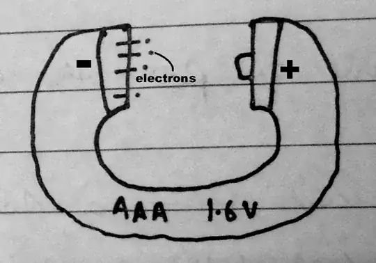

Given here is a picture of a twisted battery kept in free space (vacuum). Will the battery discharge quickly? I mean, it should discharge faster than it would if we were to connect the terminals with copper wire.
The reason I give is simply that attraction from some opposite charge induces motion in an electron. The resistance to its flow is caused by the medium. If the medium was empty, there would be no resistance, hence empty space should conduct electricity better than copper wires!
So will the battery as shown discharge quickly if kept in vacuum?

How quickly discharge will occur in the situation you sketch depends entirely on the surface properties of the negative electrode. For current to flow, electrons need to be released from the negative electrode; once they are free, they will accelerate unimpeded to the positive electrode. They will arrive there with 1.5 eV of energy, causing a small amount of heating on impact.
The medium (or lack of it) does not determine the discharge current - it is the surface properties of the cathode. More specifically, it is the local field strength right at the surface. Field strength is initially determine by the cathode-anode spacing, but there can be a (very) significant local enhancement due to surface roughness (asperities).
The "cold cathode" emission usually requires quite a high field strength; by looking at the potential difference actually needed you can learn a lot about the field enhancement, and this is actually used as a way to study surface roughness. Discharge current is described by the Fowler-Nordheim equations. Without going into too much detail, they basically describe the probability that an electron can tunnel through the barrier provided by the surface work function. This probability depends strongly on temperature (which is why hot cathodes work in cathode ray tubes etc), and the work function. At room temperature, at the kind of electric fields that can be created with an AAA battery, the leakage in the electrolyte of the battery is likely to be much more significant than that leakage through the vacuum.

In vacuum there are no charge carriers like ions or electrons. With nothing to carry charge, i.e. current, such a battery would discharge much, much slower than when the battery poles are connected by something that can carry charge like a conductor or an imperfect insulator.

Electrons (and other charge carriers, e.g., ions) in vacuum travel without resistance. However, as pointed out, correctly, in the other answers, there are no charge carriers in vacuum.
Nevertheless, electrons can escape from the terminals if they have a kinetic energy which is bigger than the potential barrier of the terminal surface, i.e., the work function $W$ of the material. If the kinetic energy of the electrons is bigger than the work function, the battery can discharge in a finite time. This condition can be obtained either if the potential difference between the two terminals or their temperature is high enough. In the first case one obtains an electric arc (a small-scale lightening), while the second case one has a steady charge transfer (thermionic effect).

Lines of electrostatic force exist between the positive and negative poles of the battery, even though they're separated by a vacuum. Vacuum permittivity is ε0 = 8.854 * 10^-12 farads per meter. By convention, this is called the dielectric constant of 1, a baseline against which the dielectric permittivities of other materials are compared. (https://en.wikipedia.org/wiki/Vacuum_permittivity).
But even though a vacuum is highly permittive of electrostatic field lines, it contains no atoms to ionize, nor any electron cloud such as exists in copper through which the electrons can transfer their charge, so a greater potential difference is needed. For example, high voltage capacitors use vacuum as the dielectric to maximize the charge stored on the capacitor plates. They charge and discharge through the vacuum, but at very high voltages and high temperatures.
You could augment the potential difference by shaping the negative terminal into a point in order to concentrate electrons there, or you could roughen the surface of the negative terminal to create many points of concentrated charge, or you could heat the terminal to give kinetic energy to the electrons concentrated there. If the concentrated charge exceeds the dielectric property of the vacuum, electrons will leave the negative terminal. But an ordinary battery will not discharge very well through a vacuum unless the potential difference is augmented by temperature, geometric shape, and/or material properties.
