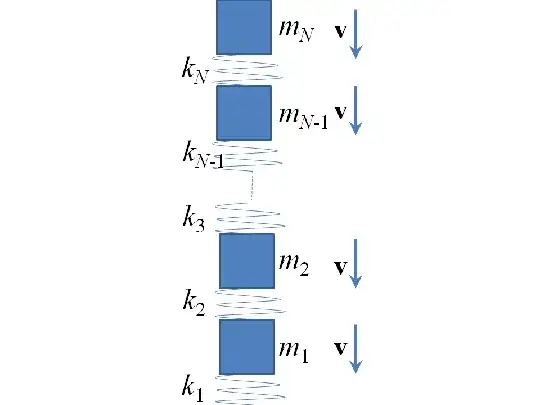

I have sketched a system below whose mathematical description will give you full insight into the problem, if you care to write down and solve the equations of motion for the discrete masses. Here we model the body as an array of masses $m_j$ separated by springs (connective tissue) with spring constants $k_j$, and the masses are all moving towards the ground at the same velocity $\vec{v}$ when the first spring is brought to an abrupt halt at its lower edge. You will find, amongst other things a maximum force (proportional to connective tissue stress) for each spring, that the lowest springs undergo the greatest peak stress (corresponding to the everyday observation that you bruise at the surface of an impact and the injury diminishes with depth i.e. distance from the bruise) and that the peak stress in each spring can be "engineered" considerably by using a varying spring constant profile. Thus you can also play with the spring constants and, for example, design a crumple zone for a car: choose the spring constants so the first few feel the higher stress (the "sacrificial" zone) whilst those furthest from the impact feel much less and there are definite optimum spring constant profiles for this kind of thing.
Contrast all this with the case where you imagine all the body to be electrically charged with charge density exactly in proportion to the mass density. Then you accelerate the body with a whopping electric field. In this case, all parts of the body are always accelerated at exactly the same rate and there is no stress between any two parts of the body. You could accelerate arbitrarily fast with this setup and feel nothing unusual. I've read somewhere (or more likely been told by my daughter) that Emperor Palpatine's personal ship could accelerate at $1 600\,g$. With an electrostatic drive like the one above, human occupants could brook this, no problem! (aside from that now we need to find an Imperial electrostatic force drive engineer....)

This is an excellent way of putting it, and of summarizing my answer. Particularly the focus on strain. Fundamentally, we test for a kinematical consideration: if every point undergoes the same motion, no matter what the jerk, acceleration or whatever, no strain can ever result because the set of points making up the body undergoes an isometry.
Sharp deviations from this condition lead to large strains within the body, and these are calculated as sketched in my non Wiki Answer.
