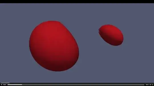

In the second part of your question, I think you are trying to arrange things such that the spaceship is sucked out of the event horizon of the first black hole by the second black. Now, if you look at the videos, you will see that when the black holes are far from each other, the event horizons that are facing each other get flattened somewhat, which I think is the effect you are looking for that you think might allow the spaceship to escape. However, if you look at the videos, you see that as the holes get even closer to each other the event horizons "reach" out towards each other and as the two cusps from each hole touch, then the black holes quickly merge into one black hole.
Here is a frame from a movie showing the event horizons flattened and the beginning of the cusps forming which will lead to the merger: Black Holes About to Merge

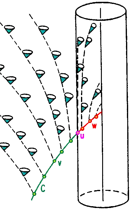

The problem with your scheme for escaping the black hole is that the spaceship will have already fallen into the singularity by the time you move the second black hole in close enough to "flatten" the event horizon. The problem is that once the spaceship crosses the event horizon, the future time-like direction has become rotated into a spatial direction towards the black hole singularity at the center. See this answer on Astronomy Stack Exchange for more of an explanation: Why can't you escape a black hole?
Here is the image from that question showing how the time direction gets rotated towards the center of the black hole:
