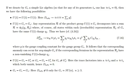

One of the sources that I've looked at is Adel Bilal's notes on anomalies (available here: Lectures on Anomalies). Here he explicitly writes

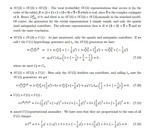

I see the hypercharges showing up, but I basically don't have the background to understand why the pre-factors of 2 etc. show up in these calculations. Bilal also writes earlier:
I'm sure the image above should just answer my question, but nonetheless I don't understand the pre-factors.

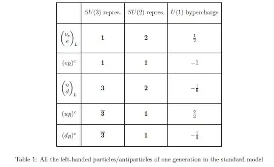

The numbers that you are referring to are just the appropriate multiplicities of the states. For example the first term in the sum in (7.19) is referring to the u and d quarks as can be seen from the factor (-1/6) of the hypercharge and table 1, but how does the counting work?
In this case the trace is over representations of $SU(3)$ so the $SU(2)$ part of the state can be taken out of the trace. Since there are 2 different $SU(2)$ options (u and d) we get a factor of 2. Schematically, if $green$,$blue$ and $red$ denote the $SU(3)$ charges/colors, one can think of it as $$u_{green}+u_{blue}+u_{red}+d_{green}+d_{blue}+d_{red}=2(green+blue+red)$$ because the $SU(2)$ type of the particles does not matter here. And the right hand side above is the analog of $2\times\text{tr}\ t_\alpha^3 t_\beta^3$.
The other two terms in (7.19) are singlets under $SU(2)$ so they get a multiplicity of 1. How about the second term in (7.20)? From the hypercharge we see that this refers again to row 3 of the table, but this time the trace is over $SU(2)$. This means that it is blind under the $SU(3)$ charges and since there are 3 of them (we get this form the first column, the charges are as many as the dimension of the representation) we get a prefactor of 3. Schematically: $$u_{green}+u_{blue}+u_{red}+d_{green}+d_{blue}+d_{red}=3(u+d)$$ because this time the $SU(3)$ charge can be taken out of the trace.
I hope this is sufficient to explain what is happening with (7.21) and (7.22) as well.
Table 1 from Adel Bilal's Lectures on Anomalies,arXiv:0802.0634 [hep-th]
