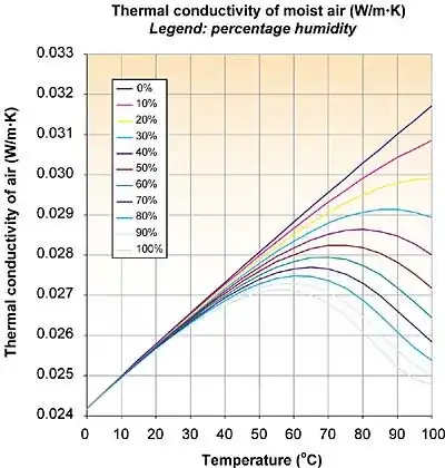

The cooling effect of air will depend in the flow rate and thermal conductivity of air. The latter is in turn a function of temperature, pressure and water content. Counter-intuitively, if we keep pressure constant, the most water the less thermal conductivity, and the decrease in thermal conductivity is more significant for higher temperatures, as shown by the following graph:
A more detailed explanation of the causes of this behavior can be found at the original source of the image: electronics-cooling.com

@Camilo Rada's answer is good, but only addresses purely conductive heat transfer (or the assumption that $\Delta T$ is constant). For convective heat transfer, you also have to factor in heat capacity as well.
Looking at Fourier's heat law $q = k \Delta T$, we've factored in the $k$ (thermal conductivity), but not changes in $\Delta T$. When a working fluid has a higher thermal capacitance, $\Delta T$ increases more slowly, thus having a higher over all $q$.
The thermal capacitance of water is discussed in this Physics SE answer, but is given by $c_p = 1.002 + 1.802H$ (kJ/kg°C), for $H$ being the percent humidity.
Thus, the answer is "it depends", based on the working temperature of the fluid (which determines the variance in $k$ with respect to humidity), and how long the fluid is in contact with the heat exchanger. If we assume a fluid working temperature in the neighborhood of 40-50 °C, then the maximum difference in $k$ with respect to humidity is around 4%, where as the change in thermal capacitance is around 80%. Obviously it'd be better to actually calculate out what the difference in heat transfer would be for a specific problem setup, but based on the above, I'd say humidity will probably be a net benefit to heat transfer, despite the reduced thermal conductivity.
